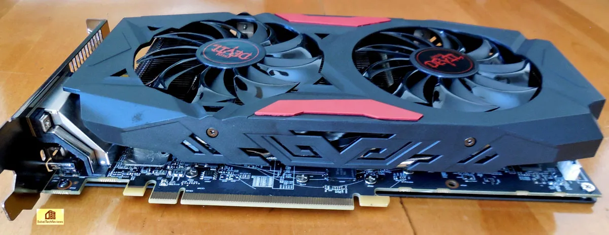

The PowerColor Red Devil RX470 is a good looking and solidly built card with twin fan technology called Double Blade III which has more fan blades for increasing airflow, and their design helps to prevent dust deposits. The Double Blade III is made with dual 80mm 2-ball bearing fans to give what PowerColor claims is 4 times more longevity than regular fans, and they act to cool the card better than the reference blower. Turning it over, we see it is has a solid backplate.
We originally pointed out that the PowerColor Red Devil card carries a hexagram inside a circle – a six-pointed star which is a symbol originating in Egypt and adopted as a symbol of the Jewish faith. Although PowerColor’s hexagram in a circle has nothing to do with the associated modern occult Pentagram symbol which is always a similarly drawn 5-pointed star inside a circle, it may well refer to the Seal of Solomon which implies that a Devil is bound within the card.

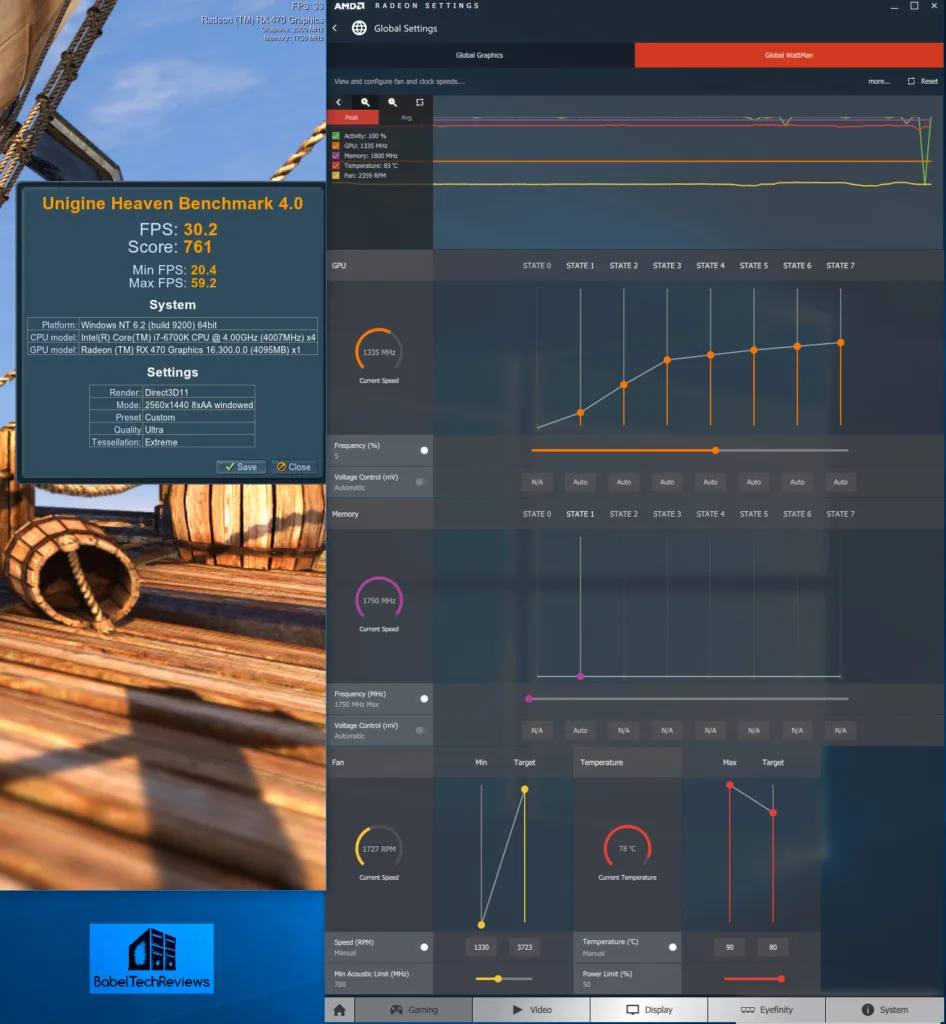

Unfortunately, PowerColor originally shipped us a Red Devil RX 470 with its clocks locked down by its Performance BIOS to reference RX 470 boost speeds (1206MHz). The only clockspeed adjustment that we were originally able to make was to increase the memory clocks by 50MHz which did not have any positive impact on performance.
Here is the screenshot of the results of looping Heaven 3.0 continuously with the original BIOS at reference clocks.

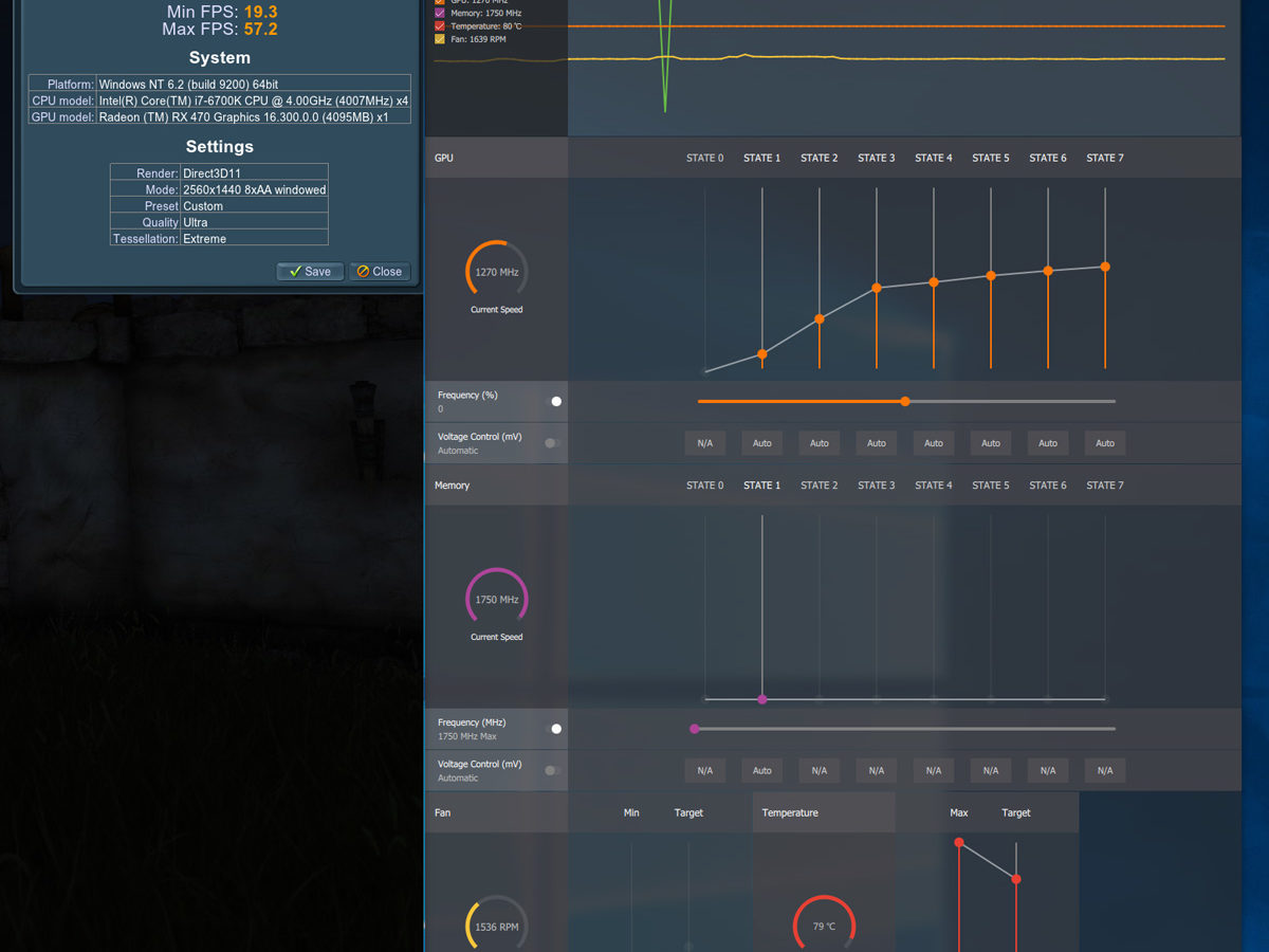

Here is the new BIOS with the PowerColor Boost clocks now steady at 1270MHz and the temperature is up by 10 degrees at 79C. The Heaven score also increased with the higher clocks over reference.

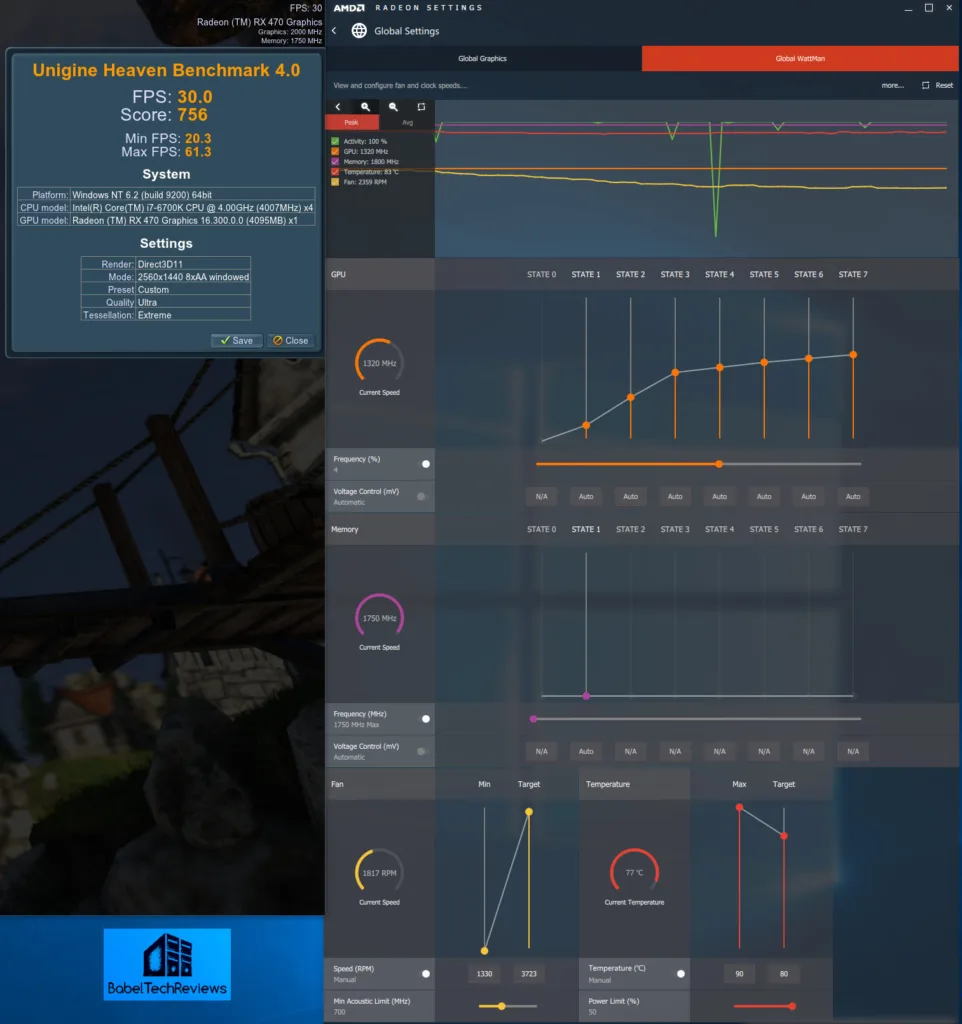

Next we tried a 2% overclock. After that, we kept the 2% overclock the same but increased the memory clocks by 50MHz to 1800MHz.
Any memory overclock impacted the performance negatively, even with a higher core overclock. So we returned our memory clocks to the stock 1750MHz and increased our core speeds to 3%.

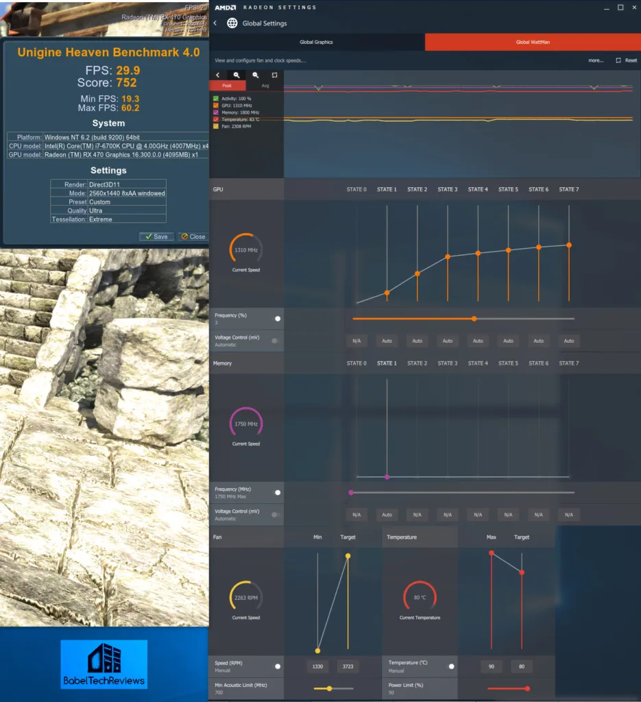

1320MHz was stable so we tried 5%
At 5%, the clock speed is 1335MHz or 65MHz over PowerColor’s clocks and 134MHz over the reference 1206MHz, and the temperature is basically unchanged from the upper 70sC to 80C. There was no throttling and the core boost speed remained consistent.
We tried 6% but the overclock was unstable and we experienced crashes to desktop. Even 5.5% was unstable for many games, so we settled on 5%, or 1335MHz boost with stock memory clocks (1750MHz). Let’s head to the performance charts to see how the PowerColor Red Devil at PowerColor Clocks (1270MHz) and further overclocked by us (1335MHz) compares with reference RX 470 speeds (1206MHz). We shall also compare it with the reference RX 480.

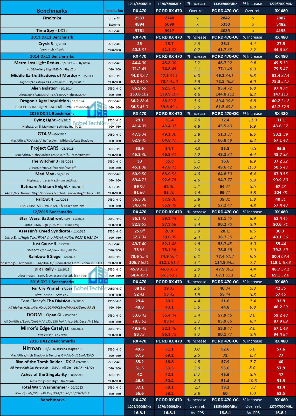

Here are the performance results of 25 games and 2 synthetic tests comparing the Red Devil RX 470 4GB at reference RX 470 clocks versus PowerColor clocks, versus manually overclocked and versus the reference RX 480, and then against 5 other competing cards.
All results except for Firestrike and Time Spy are expressed in average fps (in Bold) and also generally in minimum fps (where they make sense, in smaller italics next to the averages). Each card is compared against the other in the adjoining results column at 1920×1080 and at 2560×1440 (if it is playable). ‘X’ means the test was not run and ‘NA’ means the test would not run or could not complete.
The first column represents the reference RX 470 4GB, the second column has PowerColor RX 470 at factory clock results, the third column is the percentage of increase of the PowerColor RX 470 over reference speeds, the fourth column represents the Red Devil overclocked as far as it could stably go, the fifth column is the max overclocked percentage increase over stock clocks, and the last column represents RX 480 performance. Make sure to open this chart in a separate window or tab for better readability.
We see the $199 Red Devil RX 470 come surprisingly close to the reference $239 RX 480 performance even at stock. And when it is overclocked, Red Devil comes very close in performance to the more expensive card.
