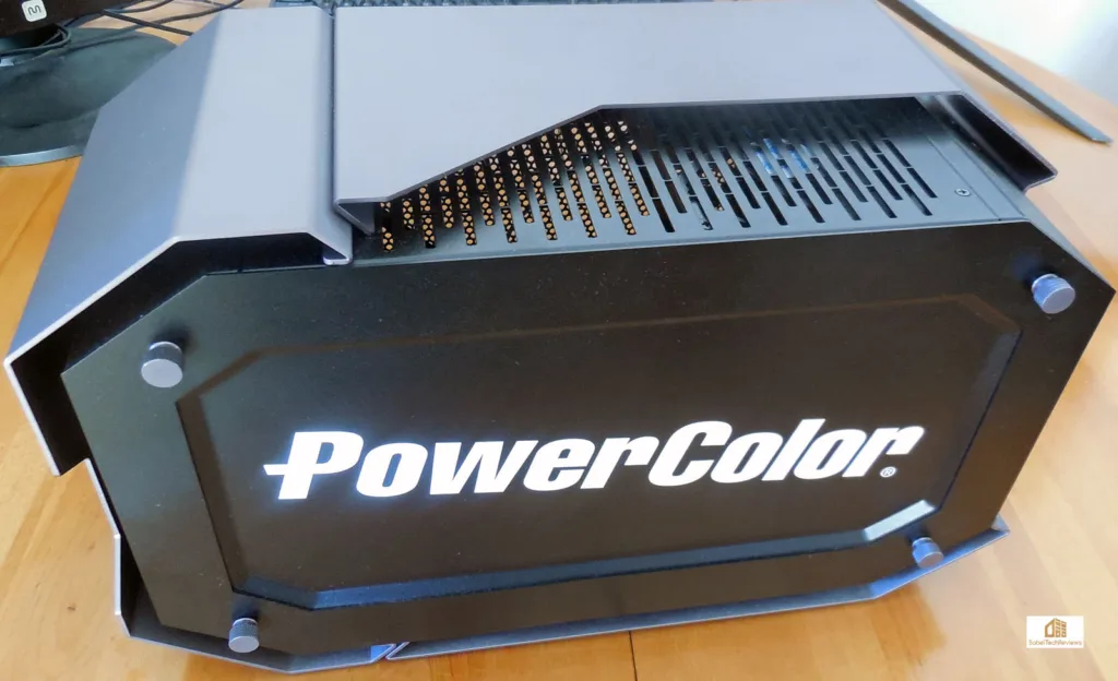

First of all, the Devil Box is large and the engineering sample is quite heavy, weighing probably more than 15 pounds. Our sample does not have a handle and may look a little different from what is finally released. It measures approximately 15.75 x 6.75 x 9.5 inches. PowerColor’s name is in large white letters on the other side.
Devil is featured on the front and there is a USB 3.1 Type C port available:

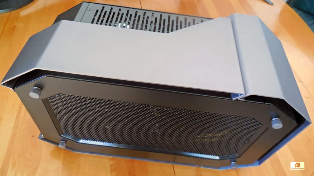

 The back of the Devil Box features 3 USB 3.0 ports, a SATA connection for an additional 2.5″ HDD or SSD, a LAN connection, and a 40GB/s Thunderbolt 3 connector. There is an off/on switch, and an intake fan together with the power cord connector also on the rear panel.

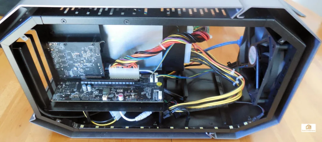

 Taking off the front grille, we see a PCIe riser slot for the video card and connections to its mini-motherboard.

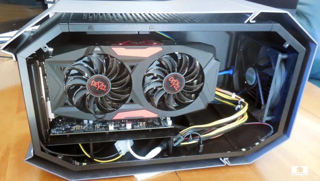

Removing the back cover reveals a Seasonic 500W slim design PSU that is often used in mini-ITX cases. 125W of the PSU is dedicated to powering the Devil Box electronics which leaves 375W for powering a video card.  Of course, we wanted to install some video cards into it to see how they would fit. First up, we tried a midrange card, the Red Devil RX 470.

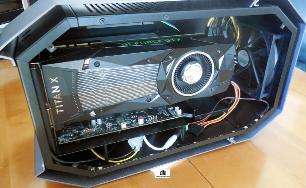

It is also very difficult to lock down the card as there is very little room to get your fingers inside the box with a thumbscrew, and it is impossible to use a screwdriver. The reference 290X is about the longest card that will fit. The Devil Box will allow a video card that up to 12.2″ in length, so a 295X2 is too long and also too power hungry. Video cards more than 5.5″ inches wide are also a no go, and they must be less than 2″ in thickness which will preclude using some of PowerColor’s own 390X or Fury designs. The Fury X card itself would fit, but the radiator would have to hang outside the case with the grille open as there is no support for AIO liquid cooling, making its use extremely unlikely.
Even though the Devil Box is based on AMD’s XConnect technology, it will accept Nvidia cards including the TITAN X. This technology allows Radeon graphics cards to be plugged into supported notebooks while it is still operating, but the system will need to be shut down before installing a GeForce card.

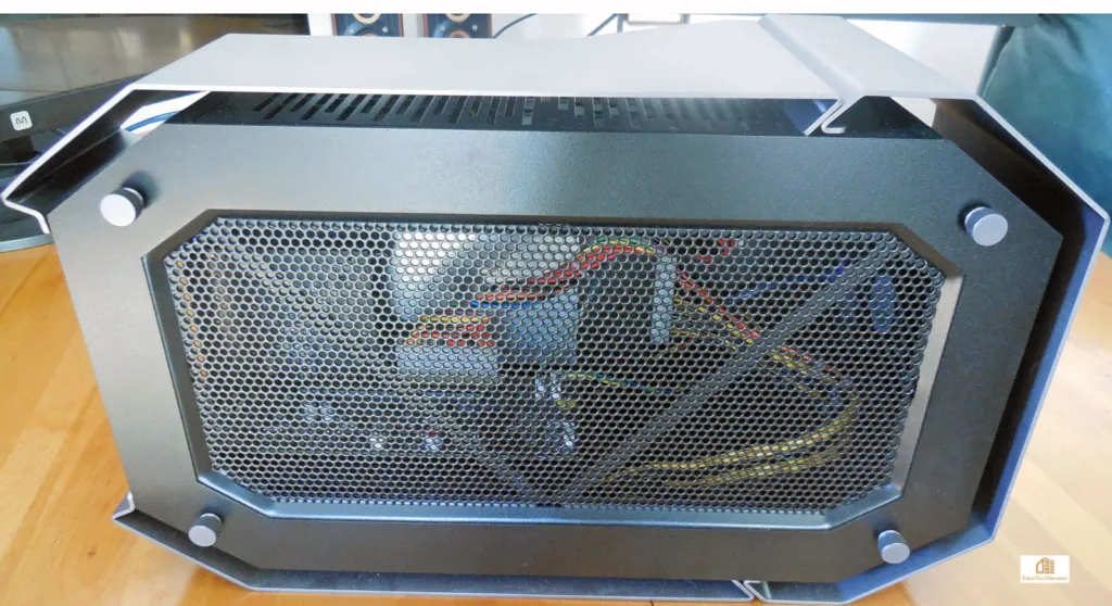

The video card can finally be displayed properly and we wish that the grille was clear acrylic plastic with holes instead of metal mesh.
The Devil Box is well ventilated with an exhaust fan on top to remove the hot air. You can mount a 2.5″ SSD or HDD inside also on the bottom in the slot provided. Here is another view looking down on the Devil box from above.

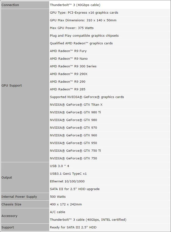

The Specifications
Here are the specifications as detailed on PowerColor’s site:
