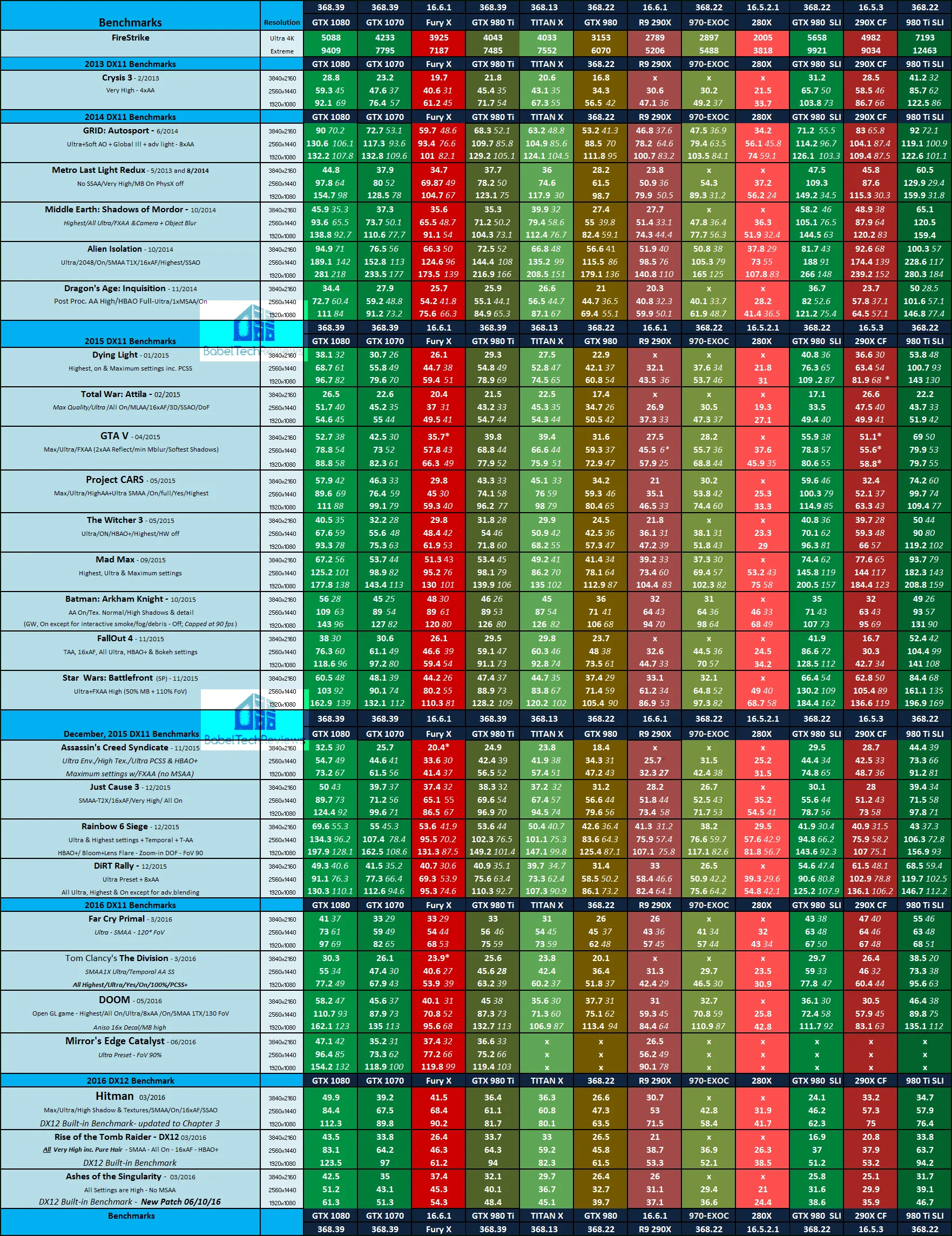

Let’s head to the chart to compare the driver progress from the 16.5.3 Crimson drivers for Fury X and the 290X to the new Crimson Software 16.6.1 hot-fix driver since we tested them the last time.
The Summary Chart
Here are our results of 26 games and 1 synthetic test. The drivers are noted on the chart. “X” means the benchmark was not run and “NA” means the benchmark could not be run or completed. And an Asterisk (*) means that there are some real issues with the visuals.
All results except for Firestrike are expressed in average fps (in Bold) and also generally in minimum fps (where they make sense, in smaller italics next to the averages). Each set of drivers are compared against the other in the adjoining results column in white (newest 16.6.1 driver) versus black (older 16.5.3 drivers).
main-chart
As usual, we note mostly incremental improvements with the latest drivers, but this time, they are generally positive on for the Fury X, while the 290X regressed in performance for quite a few games, sometimes noticeably as in Battlefront. Continued negatives included both The Division and Assassin’s Creed Syndicate with Fury X at 4K where memory management still appears to be weak compared with the last WHQL driver. GTA V showed some instability and some stuttering with the latest drivers for both the 290X and the Fury X, but at different resolutions.
Hitman’s performance should not really be compared with the last driver as the latest Chapter 3 brought some minor changes to the benchmark itself.
The Big Picture once reserved for video card reviews has been expanded to feature all of our competing cards on recent drivers.
The Big Picture
Here’s our latest Big Picture including the GTX 1080. We are beginning with the GTX 1080, the GTX 1070, and the GTX 980 Ti versus the Fury X, the TITAN X, the GTX 980 and the GTX 970 EXOC versus the R9 290X and versus the R9 280X. We also show 290X CrossFire and GTX 980 and 980 Ti SLI results. The video cards are tested on the driver sets as shown on the top and bottom lines of the Big Picture.
The highest settings are always chosen and it is DX11 when there is a choice (except for Ashes of the Singularity, Hitman, & Rise of the Tomb Raider which are always run in DX12), and the settings are ultra. Specific in-game settings are listed on the chart.
The benches are run at 1920×1080, 2560×1440, and 3840×2160. All results, except for Firestrike, show average framerates and higher is always better. In-game settings are fully maxed out and they are identically high or ultra across all platforms. “NA” means the game would not run at the settings chosen, and an *asterisk means that there were issues with running the benchmark, usually visual artifacting. “X” means the benchmark was not run at all.
big-picture
