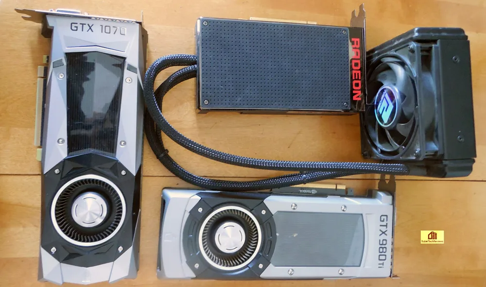

It’s been at least six months since BTR compared the Fury X versus the GTX 980 Ti and versus the GTX 1070. It will be interesting to see if there have been any major changes since then. Has Nvidia neglected Maxwell in favor of Pascal? This evaluation will revisit 25 games from our last Fury X versus GTX 980 Ti evaluation and we will also include the GTX 1070. We will use the same games that we benched then, and we will again compare them using the latest drivers, plus we will add 11 newer games including Watch Dogs 2.fxvtiv1070
Both the GTX 980 Ti and the Fury X launched at $650 and have been natural competitors. However, just over six months ago, Nvidia released the GTX 1080 and the GTX 1070, and both new cards beat the GTX 980 Ti and also beat the Fury X. Today the Fury X and the GTX 980 Ti are often discounted below $400 which is about where the GTX 1070 is priced, although the GTX 1070 and GTX 1080 are now bundled with Watch Dogs 2.wd2-lst
Our game benchmark suite has changed in the past six months as we always strive to update our tested games to include the latest and most popular titles at the time of writing. Since then, we have also upgraded from Devil’s Canyon i7-4790K at 4.4GHz to Skylake i7-6700K at 4.4GHz, but we found almost no performance difference between the two platforms.
We mainly want to see how these formerly flagship GPUs stand now in relation to each other by playing the latest games with updated drivers at demanding settings that we usually bench at as well as by replicating the test conditions of our last Fury X vs. GTX 980 vs. GTX 1070 evaluation as well as we can at 3840×2160, 2560×1440, and at 1920×1080.
We will be interested to see how the Fury X stands up to the latest games with its 4GB of vRAM, and if the GTX 1070 is pulling further away from the GTX 980 Ti. Watch Dogs 2 is vRAM intensive and its recommended specs are pretty steep.watchdogs2-2016-11-30-11-09

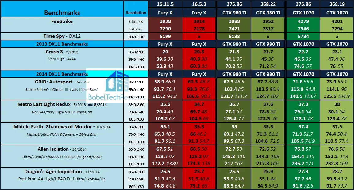

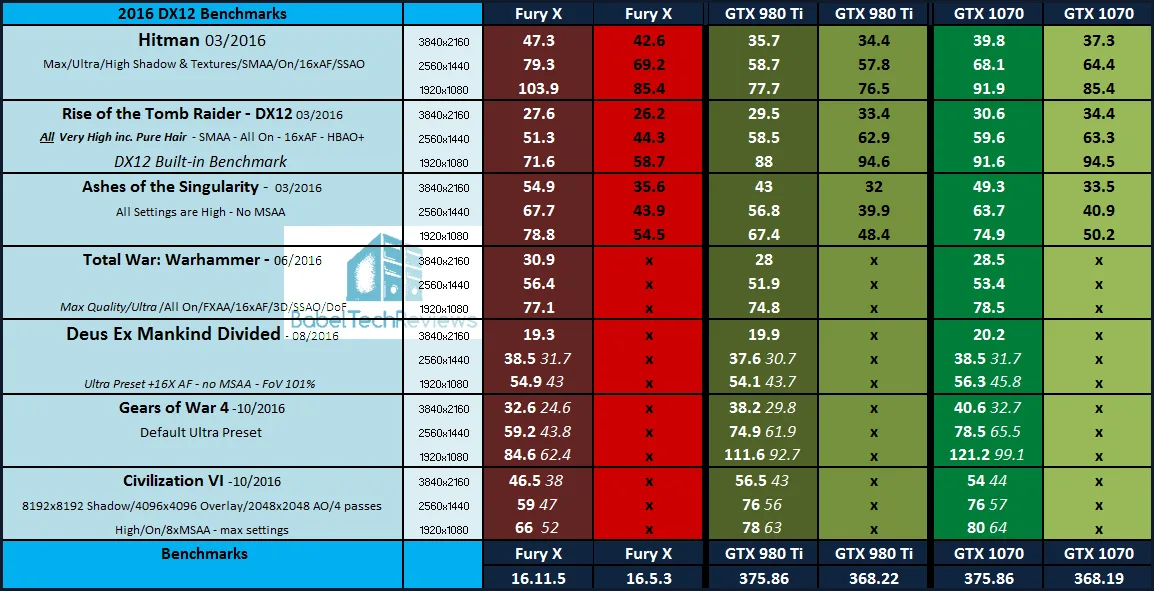

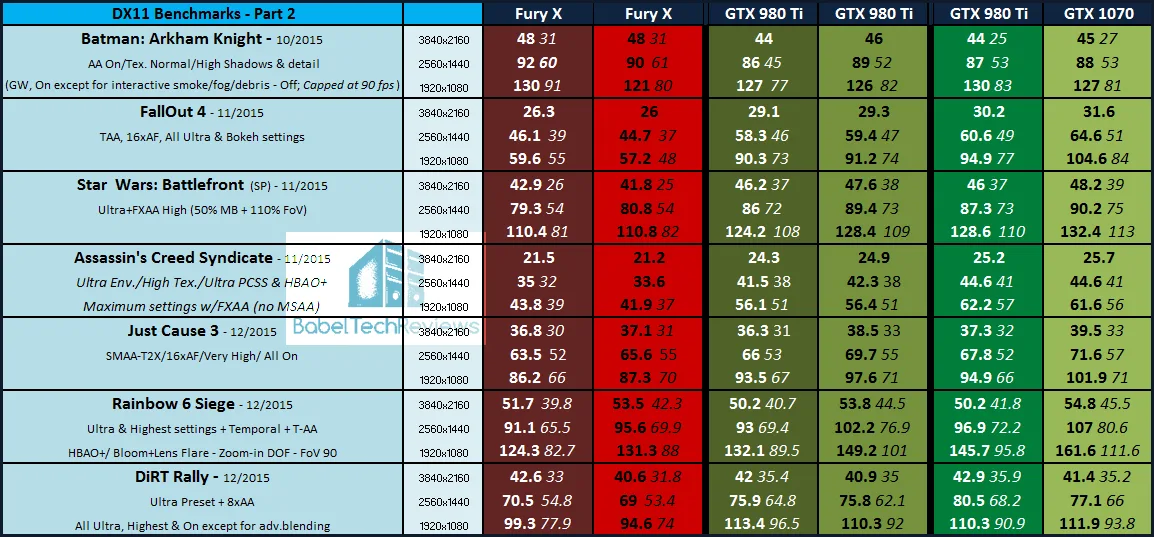

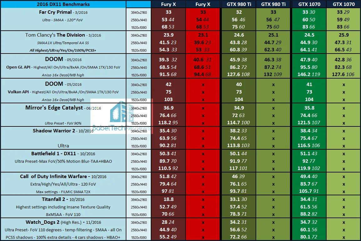

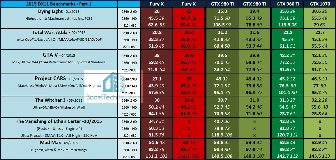

Here are the summary charts of 36 games and 2 synthetic tests. The highest settings are always chosen and it is DX11 or DX12 with the settings at ultra or maxed except for DOOM which show both Vulkan and OpenGL results (different areas were benchmarked with each API). Specific settings are listed on the main performance chart.
The benches were run at 1920×1080, 2560×1440, and at 3840×2160. All results, except for Firestrike and Time Spy, show average framerates, and higher is always better. In-game settings are fully maxed out and they are identically high or ultra across all platforms. “X” means the benchmark was not run as many new games have been added in the past 6 months to BTR’s benchmarking suite.
The first two columns are devoted to the Fury X results with the latest drivers being used in Column 1 and the May drivers compared in Column 2. The GTX 980 Ti results are given in the center two columns with Column 3 using the November drivers and Column 4 using older May drivers. The last two columns show the GTX 1070 results with Column 5 showing the new drivers and Column 6 giving the performance results with the launch drivers.
Please open the charts in separate windows or tabs for better viewing.untitled-1untitled-2untitled-3untitled-4untitled-5
Our chart provides a lot of information across 36 games and 2 synthetics. What we can take away from the results generally is that the GTX 1070 is still the fastest single GPU video card of the three cards with the GTX 980 Ti in second place.
Overall, the GTX 980 Ti is still significantly faster than the Fury X in the majority of our games although the Fury X has been able to gain a little ground – 7 additional benches out of the 75 we originally tested are now in the Fury X’ favor – although it is still bested by the GTX 980 Ti overall. We don’t see the GTX 980 Ti losing any ground in the older games to the GTX 1070, although the newer card pulls further ahead in some of the newest games.
We continue to see good optimizations being made for the GTX 980 Ti although they appear smaller than for the GTX 1070. And as AMD’s flagship, we see AMD’s driver team continue to optimize it, making good on their progress to manage its limited 4GB of vRAM rather well. The games where Fury X had issues at 4K – especially with Assassin’s Creed Syndicate and GTA V – are now playing much better now than they were 6 months ago.
Titanfall 2 and to a lesser extent, Watch Dogs 2, appear to be currently problematic for the Fury X at the highest resolution possibly due to the extreme settings and its limited vRAM, and we look for later driver updates to probably address this. Fury X still leads even over the GTX 1070 in AMD-sponsored games like Hitman, Deus Ex Mankind Divided, and Total War Warhammer, and also in DOOM on the Vulkan API; but the vast majority of our 36 tested games favor the GTX 980 Ti and especially the GTX 1070.
