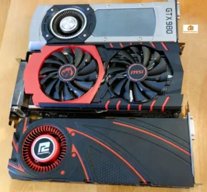

r9 290x0C 300x183 PowerColor R9 290X OC vs GTX 780 Ti the overclocking gloves come off!Evidently the early Hawaii GPUs at their launch barely met specifications as the reference cooler was unable to cool them properly without throttling the clock speeds. At Hawaii’s launch, AMD was determined to beat the original TITAN’s performance even if it meant running the 290X on the edge with Uber clocks and with uber noise.
Newer Hawaii GPUs evidently have no such throttling issues with the reference cooler as long as the gamer is willing to put up with what most consider excessive noise from a fan that spins up to 55% when the GPU hits 94C. This is a rather big issue that CrossFire users face when picking a 290/X video card – either use reference and put up with extreme noise from two cards, or use an open design for multiple cards and roast the interior of your case and the PC hardware inside. Of course, the ideal solution is to watercool two Hawaii or Grenada GPUs, but it is expensive.
Enter the higher clocked and faster R9 390X. AMD has no reference version, so for 390X CrossFire this means putting two open-design 390Xes into a case which may overwhelm its cooling. The 390X still uses the same GPU as 290X, but higher clocks now require higher voltage and there is even more heat to deal with. The MSI TwinFrozr V model cooler is now more than 2 slots wide to keep the 390X cool, and it is very effective at idle when the fans may even shut down. However, at load the card makes itself known, although it is more like a rush of air – much like the GTX 980 Ti reference version – and not annoying nor intrusive like the hairdryer-like sounds of the reference 290X at Uber speeds.

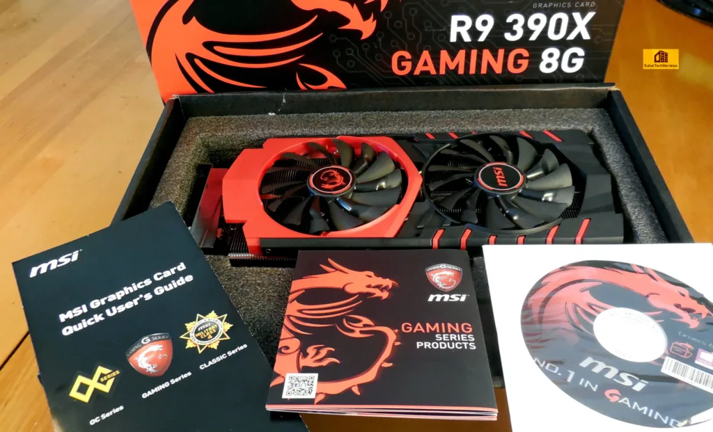

First, let’s take a closer look at the new MSI R9 390X Gaming 8G OC as we unbox it.
Unboxing the MSI R9 390X Gaming 8G OC
The MSI R9 390X Gaming 8G OC comes in a standard sized box that advertises the 8GB GDDR5, the fact that it is PCIe 3.0, and that it is the OC Edition (overclocked). DSCN0660The back of the box shows that it uses Torx optimized fans for cooling, it supports ZeroFrozr to stop the fans from spinning under some idle conditions, and MSI new Gaming App for Silent, Gaming, and OC Modes. The back of the box also advertises its key features, as well as emphasizes FreeSync, Eyefinity, and LiquidVR. System requirements are also detailed (Minimum 750W PSU with PCIe 6-pin+8-pin cable connections).DSCN0663
The box end cap show the R9 390X is the MSI “Gaming G Series”.DSCN0664Here is everything with the cover opened. The card’s packing material is anti-static.DSCN0667

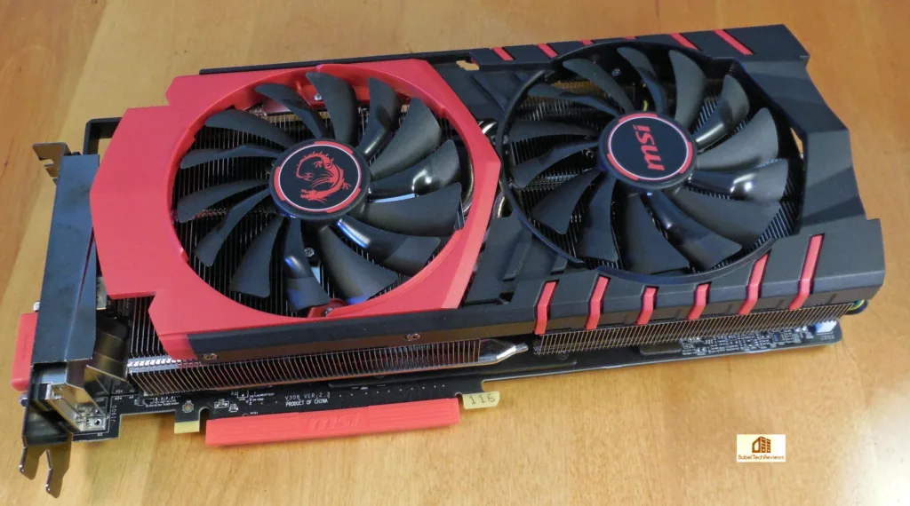

The MSI TwinFrozr V MSI R9 390X is a handsome black and red dual-fan card that covers a large radiator. It will take more than two slots in your PC, making it effectively a thin 3-slot card. The fans spin relatively slowly compared with the reference version – about 2000 rpm maximum. They are not noisy like the 290X reference version, but under load they make themselves heard above the case fans. Of course, this makes perfect sense because there are two slower turning TwinFrozr Torx fans to remove the GPU heat, compared with a double speed single fan in the reference version.DSCN0668
We turn the card on its edge and look at the relatively wide design of the cooling fins which do not allow the card to fit into a PC motherboard’s double slot configuration. Besides drawing power from the PCIe slot, there are a 6-pin plus an 8-pin connector.DSCN0684 copy 2
Here is a look from the other edge. The MSI and Dragon Logo lights up and you can pick your color. The heat sink area is quite large.DSCN0681Another view showing the backplate:DSCN0678The MSI R9 390X is a solid and heavy card that comes equipped with a backplate. It looks good inside of a PC compared with a raw PCB, and the user can have confidence when handling it.DSCN0680The MSI 390X Gaming 8G looks great from either side.

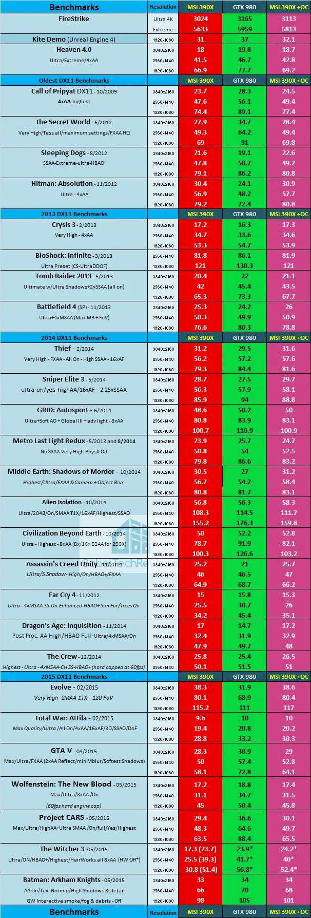

The main summary chart: The Big Picture
This main summary chart is what we call, “The Big Picture” since it places our test card into a much larger test bed.
The first column represents the GALAX GTX 970 EXOC and the second column is its competitor, the reference non-throttling 290X. The third column represents the 290X results when overclocked to its maximum 1080MHz/1425MHz, compared with the R9 390X at the same clocks in the fourth column; it is a -OC (minus overclock) on the 390X memory. The fifth bright red column represents the MSI R9 390X results at its out of the box clocks next to the sixth column (purple) which is overclocked as far as we could go on stock voltage and fan profile. In the seventh column (green: third to the last) is the reference GTX 980 results followed by the stock Fury X results in the eighth, and finally by the reference GTX 980 Ti in the ninth and last column. Please bear in mind that the Fury X results are on slightly older drivers (15.15B on Windows 8.1) for a rougher comparison, so there will be some slight variability until we receive our replacement.
Big-PicThis chart tends to be information overload, so we also break it down into two smaller charts for ease of viewing and for analysis. Our chart provides a lot of information across 26 games and 3 synthetics. What we can take away from the results generally is that the GTX 980 Ti is the fastest single GPU video card followed by the Fury X, the GTX 980, and then the MSI R9 390X. The R9 390X is faster than the overclocked 290X or aftermarket 290Xes which trade blows with the factory overclocked GTX 970.
When we compare the $429 MSI 390X Gaming 8G against the $479 GTX 980, it does OK at 3840×2160 but the gap widens further in favor of the GeForce below 4K resolutions. Neither card is particularly suited for 4K except in multi-GPU configurations in which case the 8GB of video memory will benefit the Radeon. We can see the benefits of the 390X with 8GB vRAM in Wolfenstein at 4K where the 290X with 4GB of vRAM chokes completely, yet a 4GB card like the GTX 980 is still faster. However, at these extreme settings, no single video card can run this benchmark well at 4K, not even the 12GB vRAM-equipped TITAN X.
The 390X versus the GTX 980.
This chart places the reference GTX 980 between the stock and the overclocked results of the MSI 390X Gaming 8G.
390xv980
The MSI card almost catches up to the GTX 980 at 4K which is impressive until we realize that the GTX 980 can be overclocked much further that it can.

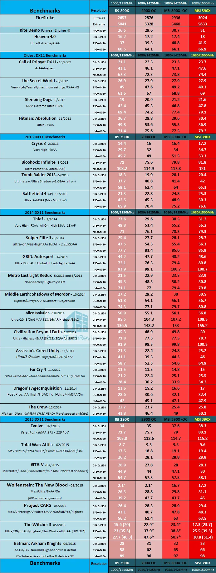

The Overclocked 290X 4GB versus the 390X at the same clocks.
This chart will give us a comparison directly between overclocked results for the 290X at 1080/1425MHz versus the 390X at identical clocks; the memory of the 390X is underclocked by 75Mhz. Look at the two middle columns for the direct clock for clock comparison.
390xv980-fix
What we see is that at the same clocks, the 390X is slightly faster than the 290X at the same clocks. We also checked the 390X against the 290X at reference 290X speeds to make sure that the 290X was not throttling at all – at 1000MHz/1250MHz. At 290X reference Uber speeds, the performance improvements of the 390X were still there but now much smaller. And these performance improvements of the 390X are most apparent at 1920×1080 where they are less useful than at 2560×1440 for which these card appear to be designed. And it also appears that these small performance improvements may be mostly explained by the faster timings of the upgraded and faster 8GB of Hynix GDDR5. It is doubtful that there are core enhancements to Grenada over Hawaii.
